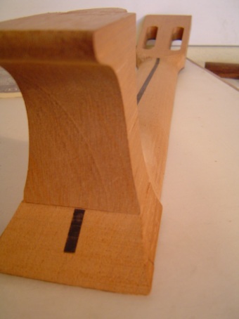

I've recently made a classical neck from cedar and put an ebony reinforcement in it to stiffen the neck, but I put it on the back side of the neck so that it adds decoration as well. This neck was just an experiment initially as I had no intention of building a classical, well of course I am now in the middle of building one an 'homage' to FE19.
ColinColin S38879.2980208333
